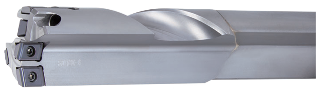

DeepTriDrill replaces a failed competitor gun drill, restoring stable 316L bores
A pump manufacturer's 41 mm x 750 mm bore in 316L stainless stopped mid-hole on a competitor's gun drill, stalling out on vibration and chipping.
DeepTriDrill dropped into the same setup with no parameter changes and ran clean. Eliminated vibration and chipping after the incumbent tool failed.
- Clean comma/helical chips, fair-to-good surface finish
- Predictable flank wear, no more edge chipping
- 51.25 cm³/min metal removal rate, held steady
- Initial Investment Paid back in one week

| Body | MCTR41.00XFM40-L750 | indexable drill K |
| Insert | FBH090404R-G-P AH725 | indexable insert |
| Grade | AH725 | coated carbide insert |
