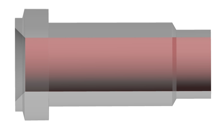

DrillMeister DMM -Valve componet –
IMPROVED TOOL LIFE AND PRODUCTIVITY
In stainless steel drilling, DrillMeister achieved a fivefold increase in tool life, improving from 60 holes to 300 holes per cutting edge, while reducing machining time by approximately 60%.
The DrillMeister DMM head, featuring a geometry specifically designed for stainless steel drilling, eliminated edge chipping, improved surface quality, and delivered excellent chip control. Combined with the benefits of the exchangeable-head system, DrillMeister provided a highly productive and stable solution suitable for long-term mass production.
