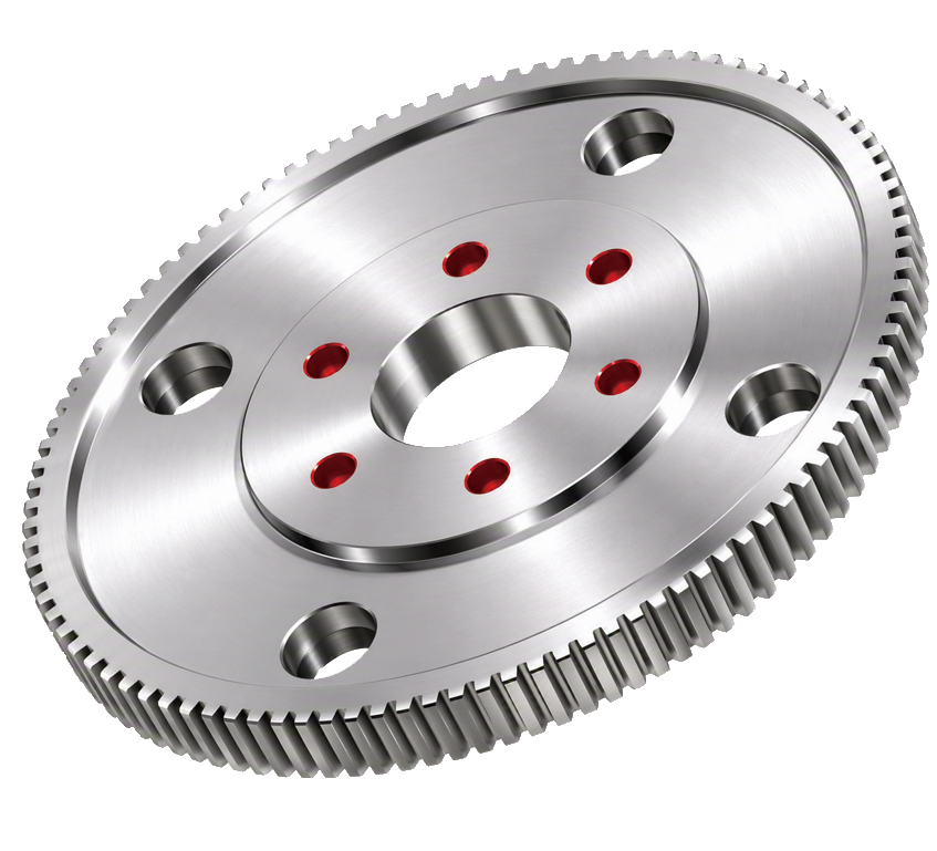

DrillMeister – Flywheel – AH9130
Improved Tool life
Tool life was extended by up to 2.7 times by applying the DMR head compared with a competitor's exchangeable-head drill.
| Component | Flywheel |
| Work material | FC250 |
| Tool category | Drilling |
| TSR No. | 5656D |
| Body | TID170F20-3 | |
| Head | DMR170 | |
| Grade | AH9130 |
| Tool diameter DC (mm) | 17 | |
| Hole depth H (mm) | 16 | |
| Cutting speed V/c (m/min) | 140 | |
| Feed f (mm/rev) | 0.3 | |
| Feed speed Vf (mm/min) | 1,049 | |
| Coolant | Wet (Internal coolant) |
