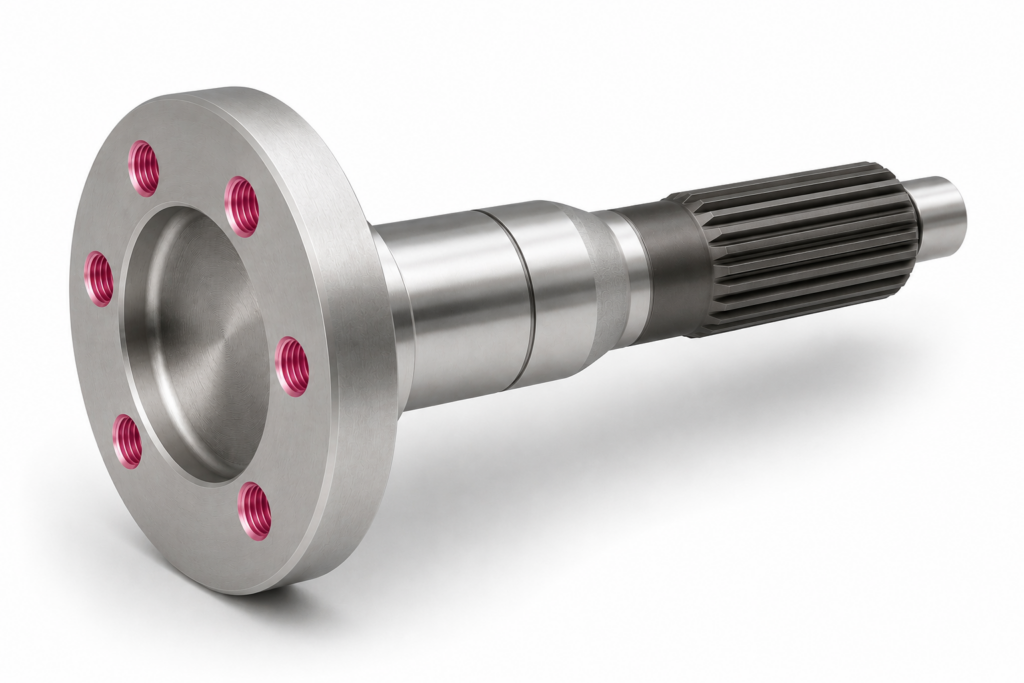

TungTap – Flange – PB070
IMPROVED PRODUCTIVITY & TOOLLIFE
TungTap exhibited stable wear behavior even under high-speed cutting conditions. As a result, it achieved 1.3 times higher productivity and 1.2 times longer tool life.
| Industry | Engineering |
| Component | Flange |
| Work material | S45C/C45 |
| Machine(spindle type) | Vertical Machining Center Middle(#40,HSK63) |
| Tool category | Tapping |
| Product name | TungTap |
| TSR No. | 5655D |
| Body | TS-M6X1-DNCM PB070 | HSS tap, M6x1 |
| Grade | PB070 | HSSE+TiN |
| Number of workpieces (pcs/insert) | 130 | 110 |
| Tool diameter DC (mm) | 6 | 6 |
| Pilot hole diameter (mm) | 5 | 5 |
| Hole depth H (mm) | 25 | 25 |
| Cutting speed V/c (m/min) | 20 | 15 |
| Feed f (mm/rev) | 1 | 1 |
| Feed speed Vf (mm/min) | 1062 | 796 |
| Coolant | Emulsion, External | Emulsion, External |
