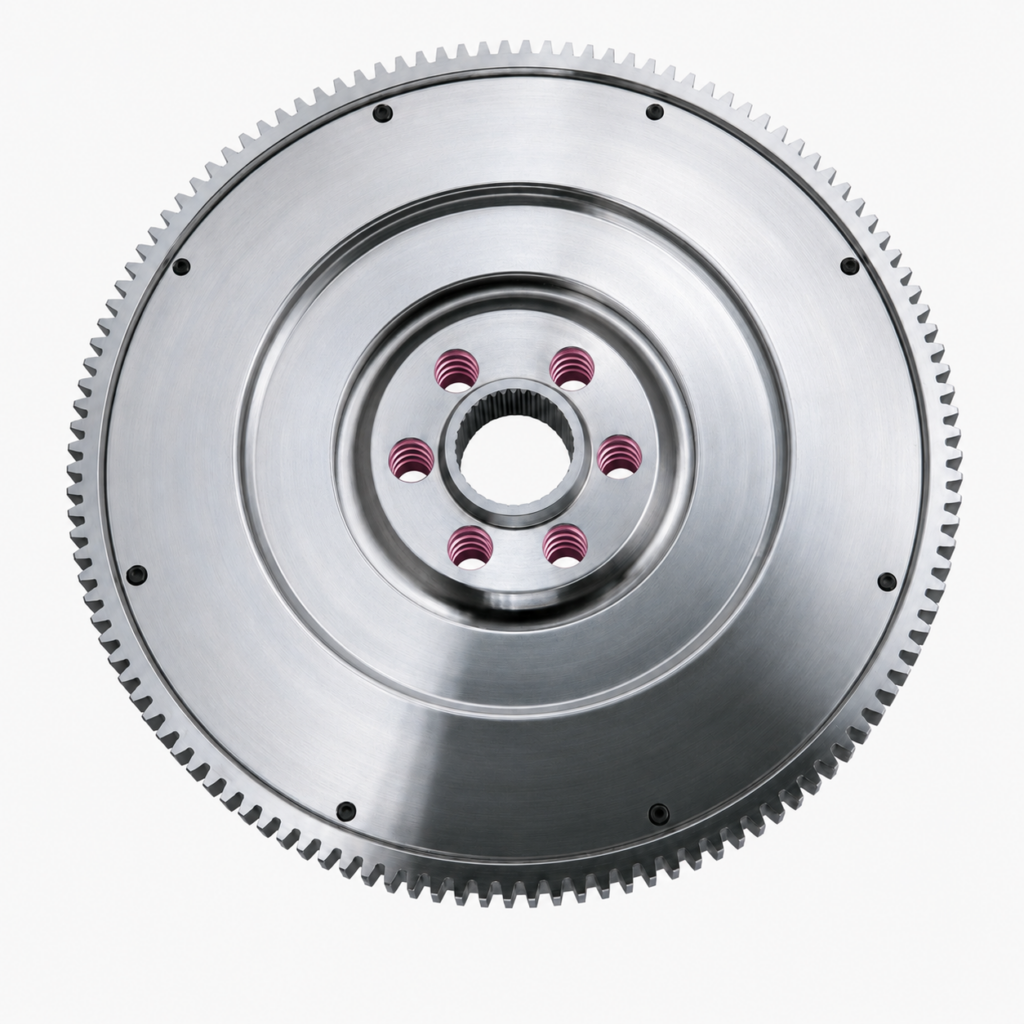

TungTap -Brake disc- AB070
Conventional taps experienced wear and chipping due to chip clogging, resulting in short tool life. The AB070 grade, which offers excellent heat resistance, suppresses wear, while an edge treatment optimized for cast iron machining helps prevent chipping. As a result, tool life was extended
| Component | Brake Disk |
| Work material | FC250/GG25/EN-GJL-250 |
| Machine(spindle type) | Multi-Tasking Machine |
| Tool category | Tapping |
| Product name | TungTap |
| TSR No. | 5646D |
| Body | TP-M8X1.25-DNBG AB070 | HSS tap |
| Grade | AB070 | HSSE+PVD |
| Number of workpieces (pcs/insert) | 4000 | 3000 |
| Tool diameter DC (mm) | 8 | 8 |
| Pilot hole diameter (mm) | 6.8 | 6.8 |
| Hole depth H (mm) | 6 | 6 |
| Cutting speed V/c (m/min) | 30 | 30 |
| Feed f (mm/rev) | 1.25 | 1.25 |
| Feed speed Vf (mm/min) | 1500 | 1500 |
| Coolant | Emulsion, External | Emulsion, External |
