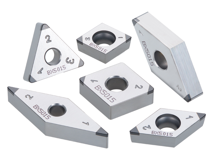

Improved Tool life
Despite cutting speed limitations caused by the irregular shape and height of the workpiece, BX5015 delivered double the tool life of the competitor through excellent low-speed wear resistance.
| Component | Bearing housing |
| Work material | FC250 |
| Product name | BX5015 |
| TSR No. | 5607T |
| Insert | 2QP-DNGA150404SR | |
| Edges par insert | 2 | |
| Grade | BX5015 |
| Cutting speed V/c (m/min) | 500 | |
| Feed f (mm/rev) | 0.2 | |
| Depth of cut ap (mm) | 0.2 | |
| Coolant | Wet |
