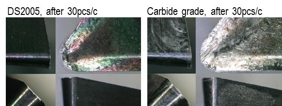

Our customer uses carbide grades to machine electrical components. With the current carbide grades, the machined surface becomes cloudy and reaches the end of its tool life after about 20-30 machining operations.
Therefore, we tested DS2005, which has excellent wear resistance and welding resistance in non-ferrous metal machining. The results showed that it achieved a superior machined surface condition compared to the carbide grade.
As shown below, when comparing the damage state after the same number of machining operations, DS2005 demonstrated superior welding resistance.
