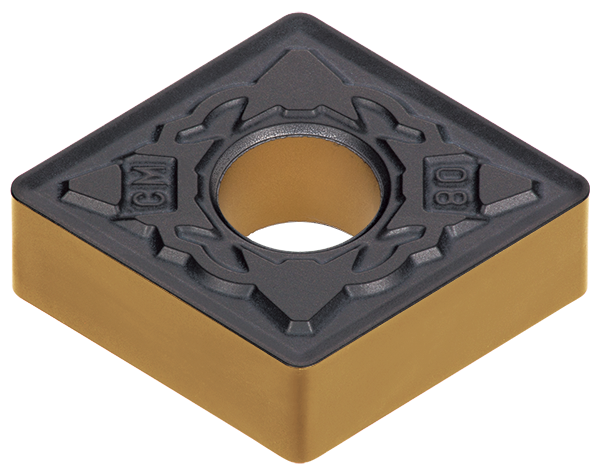

T500 series-Cam shaft-T505
IMPROVED TOOLLIFE
T505 was tested in the rough operation of camshafts for improving tool life.
As a result, it achieved 2 times longer tool life as the current product (CVD K15). T505 has overwhelming wear resistance, demonstrating superior wear resistance compared to other companies' materials.
| Component | Camshaft |
| Work material | FC250 |
| Product name | T500 |
| TSR No. | 5565T |
| Holder | ACLNR2525K12-A | ACLNR2525K12-A |
| Shank | 25 shank | |
| Insert | CNMG120408-CM | CNMG120408-medium breaker |
| Edges par insert | 4 | 4 |
| Grade | T505 | K15(CVD) |
| Tool life (pcs/edge) | 800 | 400 |
| Cutting speed V/c (m/min) | 200 | 200 |
| Depth of cut ap (mm) | 1.5 | 1.5 |
| Coolant | Wet | Wet |
