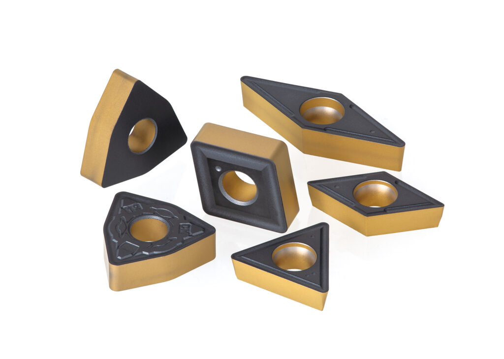

T505 was tested when finishing the face turning of brake discs. The current product could be machined up to 50 units, but the end of tool life was due to dimensional changes caused by progressive insert wear.
As a result, T505 achieved 3.6 times longer tool life than the current product.
T505 has overwhelming wear resistance, demonstrating superior wear resistance to materials equivalent to K05 from competitors.
