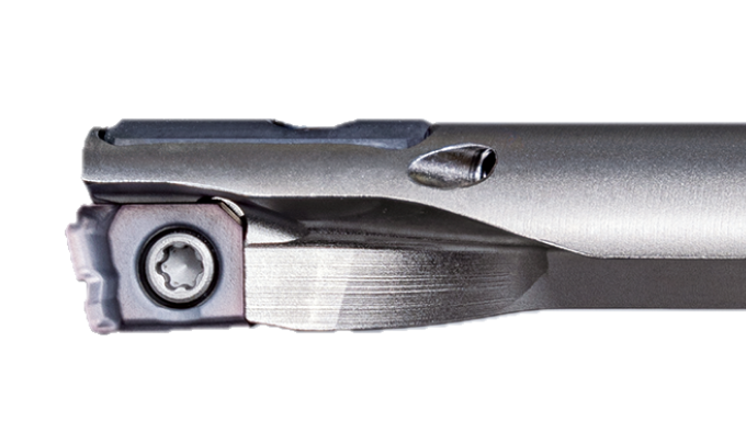

DeepTriDrill – Piston Rod – AH9130
DeepTriDrill stable chips high feed
DeepTriDrill mantain repeatable process especially in carbon steels such as S45C.
In controlled testing, the tool demonstrated strong performance at Ø13 mm, 216 mm depth, and cutting conditions of S2200 / f0.1.
Suitable for production environments requiring consistent penetration rates surface integrity and precise hole bottom shape.
Compared with a local solid gundrill, DeepTriDrill chip shape remained stable throughout testing, and bottom surface geometry was validated during the performance evaluation. The guide pad condition remained intact with no significant wear, supporting reliable bore guidance in repeated cycles.
| Component | Piston Rod |
| Work material | S45C |
| Machine(spindle type) | Gun drill machine |
| TSR No. | 5196D |
| Body | TRLG13.00X650-U04 | Brazed Gun-Drill |
| Insert | LOGT060204R-NDJ AH9130 | Brazed Tip |
| Grade | AH9130 | solid carbide |
| Machining length (m) | 216 | 216 |
| Tool diameter DC (mm) | 13.00 | 13.00 |
| Hole depth H (mm) | 216 | 216 |
| Cutting speed V/c (m/min) | 89.8 | 89.8 |
| Feed f (mm/rev) | 0.1 | 0.03 |
| Feed speed Vf (mm/min) | 220 | 66 |
| Coolant | oil | oil |
