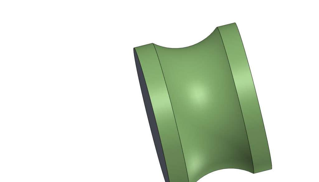

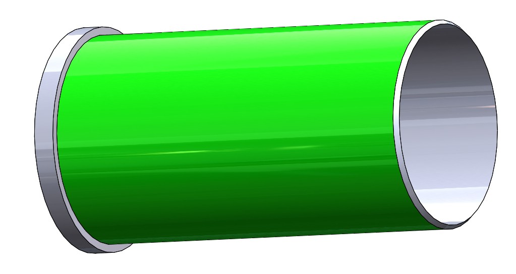

AM – Shaft – T9225
IMPROVED PRODUCTIVITY
The combination of unique “Lift-Ridge” shape edge and T9225, CVD grade, with excellent wear and fracture resistance increases productivity by 1.4 times compared to the competitor.
Industry | Automotive |
Component | Shaft |
Work material | SCr420 |
Tool family | Turning |
Product name | AM-Chipbreaker |
TSR No. | 439T |
