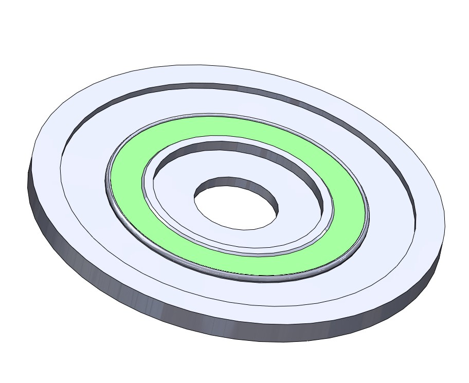

Industry Automotive
Component Differential Ring
Work material SCM418
Tool family Turning
Tool category Internal & Face turning
Product name SW and FW
TSR No. 477T
Differential Ring
Holder A32S-PWLNR08-D400 A32S-PWLNR08-D400
Insert WNMG080408-SW WNMG080408-Medium chip breaker
Grade T9225 CVD(P25)
Cutting speed V/c (m/min) 350 350
Feed f (mm/rev) 0.4 0.3
Depth of cut ap (mm) 0.5 0.5
Coolant Wet Wet
Productivity1.3 times
