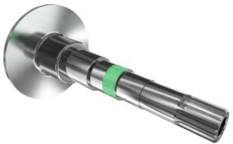

- T9225 grade with excellent wear and fracture resistance delivers stable machining even in heavy interrupted cutting. As a result, ISO-EcoTurn’s tool life is 1.5 times longer than the competitor that often gets fracture!
Economical advantage
- The ISO-EcoTurn inserts provide the same level of cutting performance as the regular-sized inserts in machining with up to 3mm depth of cut. Compared to the regular-sized inserts, the ISO-EcoTurn inserts are dimensionally smaller, which helps significant cost reduction.
| Industry | Oil & Gas |
| Component | Hydraulic Components |
| Work material | S45C/C45 |
| Product name | ISO-EcoTurn |
| TSR No. | 407T |
| Holder | AWLNR2020K0604-A | DWLNR2020K08 |
| Insert | WNMG060404E-TM | WNMG080404-Medium chip breaker |
| Edges par insert | 6 | 6 |
| Grade | T9225 | CVD(P25) |
| Tool life (pcs/edge) | 150 | 100 |
| Cutting speed V/c (m/min) | 300 | 300 |
| Depth of cut ap (mm) | 1.4 | 1.4 |
