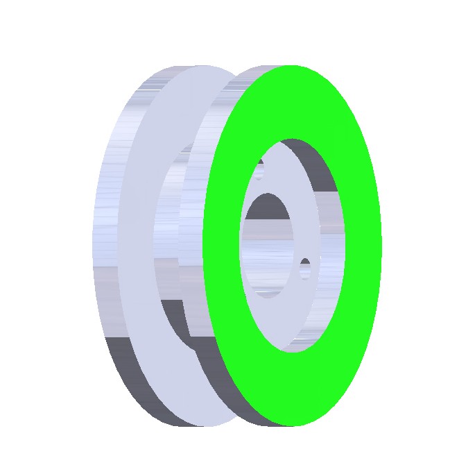

- The current item had trouble with chip evacuation because of a ground chip breaker. Also, the chip breaker often scratched the workpiece, producing more defects.
- TetraForce-Cut controls chipping using a 3-dimensional chipbreaker without wrapping around the tool or workpiece. As a result, TetraForce-Cut perfectly machined with no defective products.
