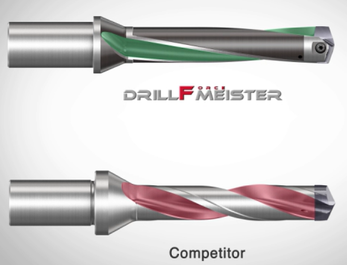

DrillForceMeister -Axle shaft- AH725
Customer used a competitor’s head changeable drill with short tool life.
The combination of DrilForceMeister which has high-rigidity clamping system with screw and dedicated grade for drill AH725 achieved 2.2 times better tool life.
