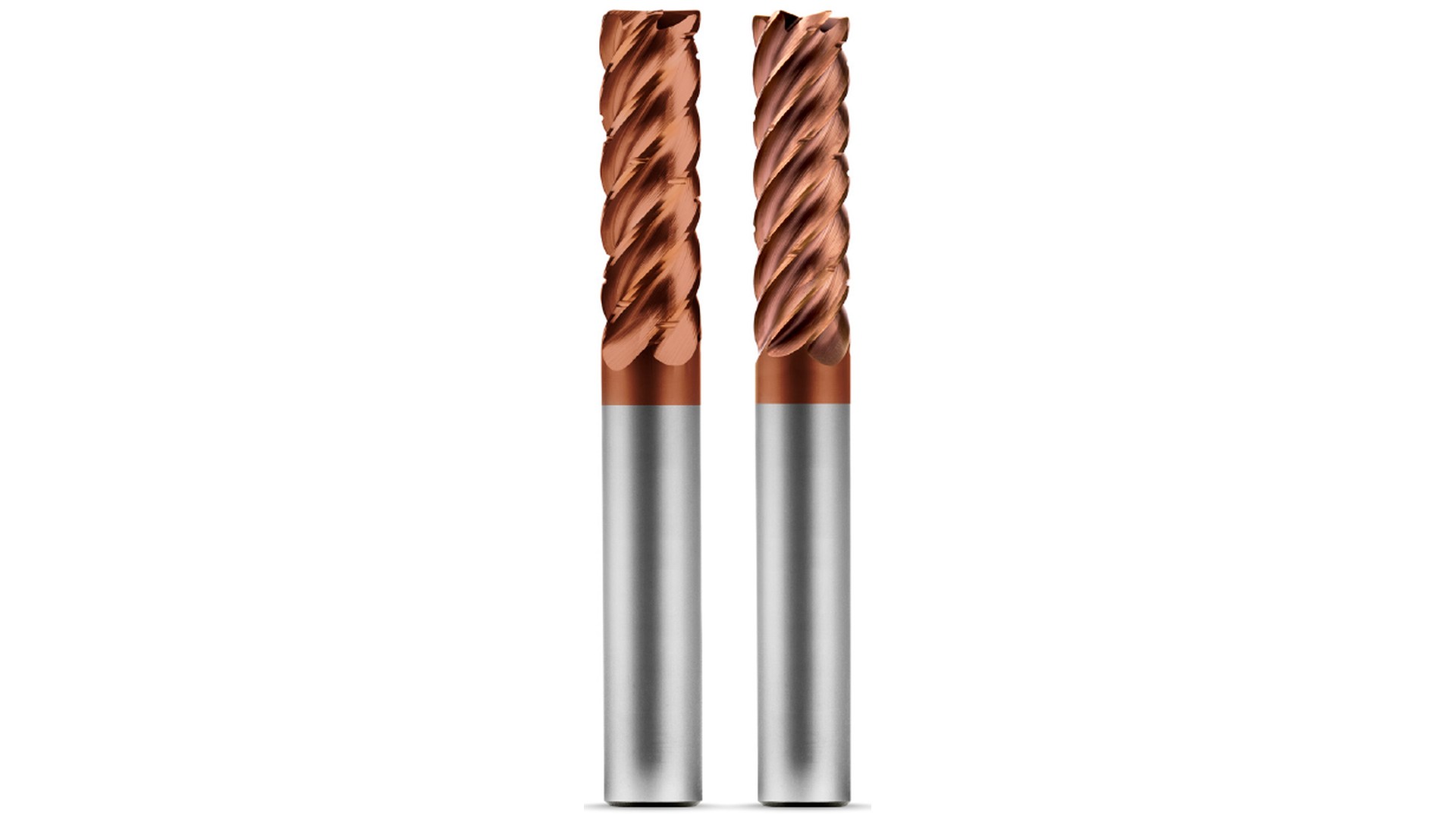

UOP’s MEGA-Troco features a sharp cutting design and chip splitter, enabling stable machining even on workpieces with low clamping rigidity. It has achieved twice the tool life compared to competing products.
