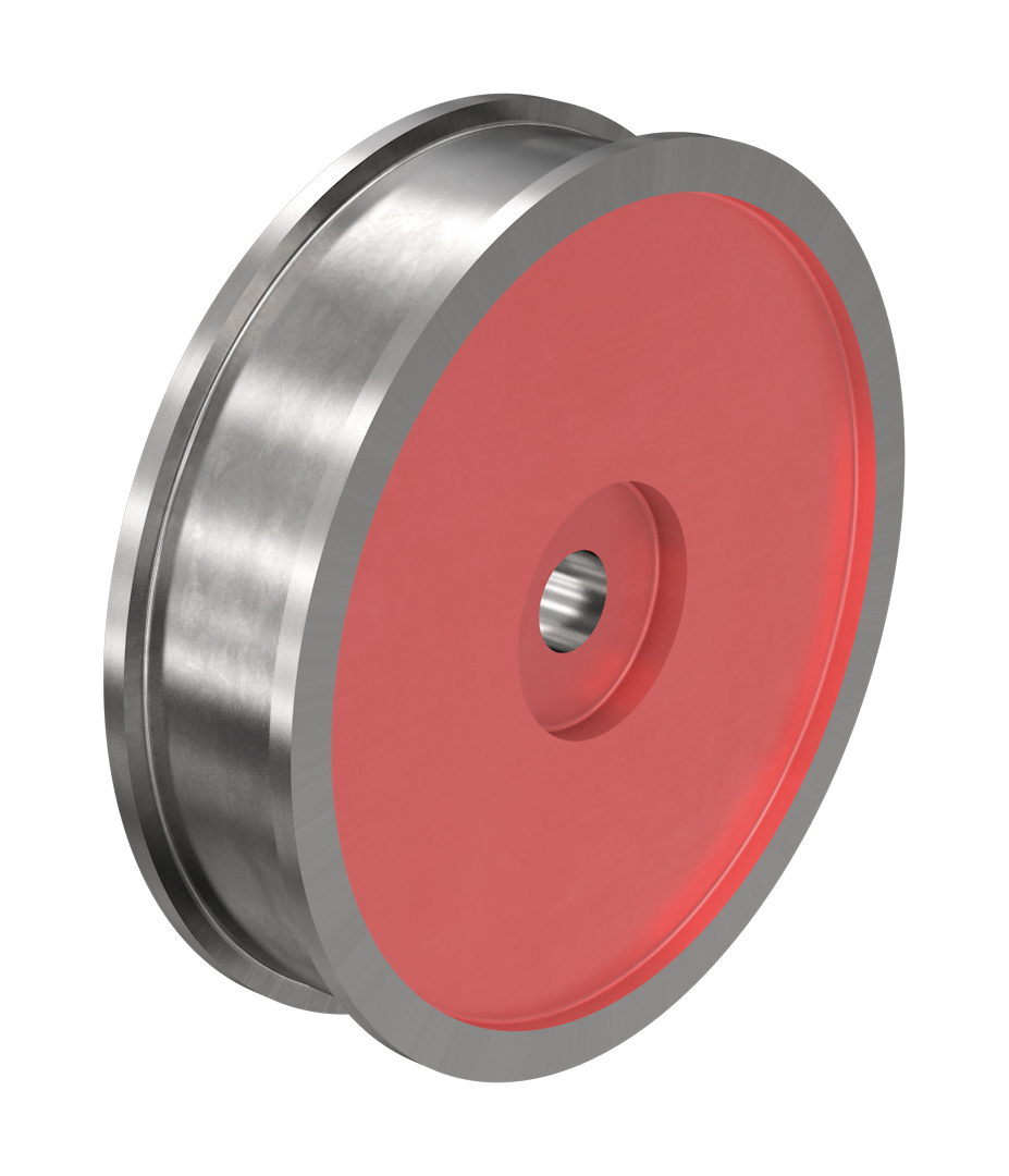

Excellent wear & plastic deformation resistance:
- T6215 with SM chipbreaker offers excellent wear resistance and chip control in continuous cutting of Desk brake parts.
- T6215’s excellent wear and plastic deformation resistance inhibit the insert from notch wear, a typical problem in stainless steel machining, leading to longer tool life than competitors.
| Industry | Engineering |
| Component | Machine Parts |
| Work material | X30Cr13 |
| Product name | T6200 |
| TSR No. | 192T |
| Holder | PSBNR2525M12 | PSBNR2525M12 |
| Insert | SNMG120408-SM | SNMG120412-Medium chip breaker |
| Grade | T6215 | CVD |
| Tool life (pcs/edge) | 50 | 30 |
| Cutting speed V/c (m/min) | 282 | 282 |
| Feed f (mm/rev) | 0.3 | 0.3 |
| Depth of cut ap (mm) | 1 | 1 |
