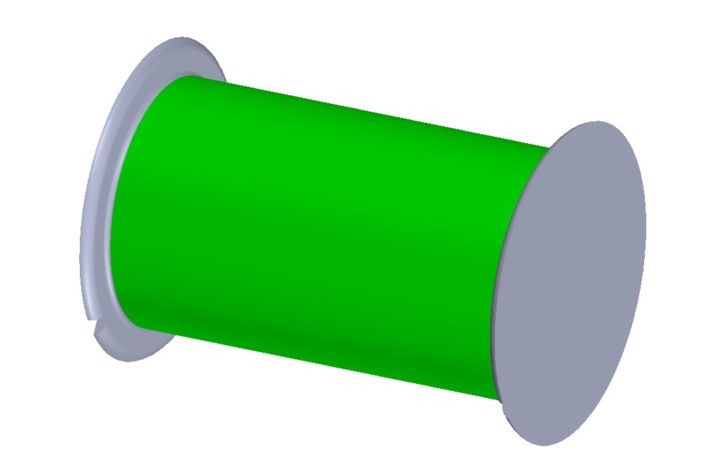

TurnTec – Shaft – T9225
- Due to a large inclination on the cutting edge, TurnTec reduces cutting forces. Thus, it enables stable machining even with 1.3 times higher feed rate and depth of cut compared to the competitor.
- With the combination of tough cutting edge and high wear resistance, T9225 grade allows consistently long tool life without chipping nor abnormal wear.
| Industry | Heavy |
| Component | Shaft |
| Work material | C45 |
| Product name | TurnTec |
| TSR No. | 123T |
| Holder | TLANR2525M16 | PCLNR3225M16 |
| Insert | LNMX161612R-TDR | CNMG160608-Medium chip breaker |
| Cutting speed V/c (m/min) | 220 | 190 |
| Feed f (mm/rev) | 0.4 | 0.3 |
| Depth of cut ap (mm) | 2 | 1.5 |
