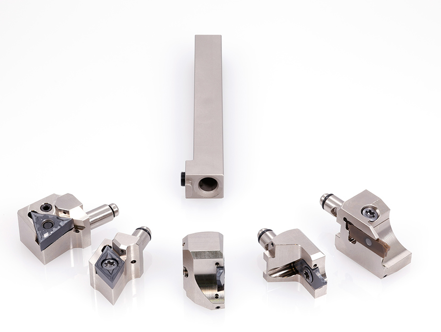

Compared to conventional screw-clamp holders, which required removing the holder from the machine for insert replacement, the N-Swiss JOINT Modular type allows quick head swaps and outside-machine insert changes. This achieves an impressive 88% reduction in replacement time.
Achieve 2.9 times longer tool life with QM3’s superior wear resistance.
