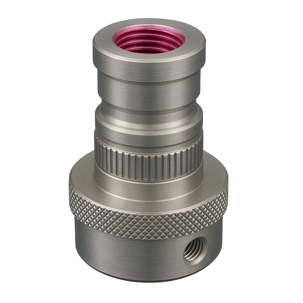

TungTap ‐ Crank shaft – PB070
Previously, a non-coated grade was used; however, during dry machining, built-up edge occurred, leading to frequent breakage. The general-purpose grade PB070 with a TiN coating suppressed both built-up edge and breakage, resulting in a threefold increase in tool life.
