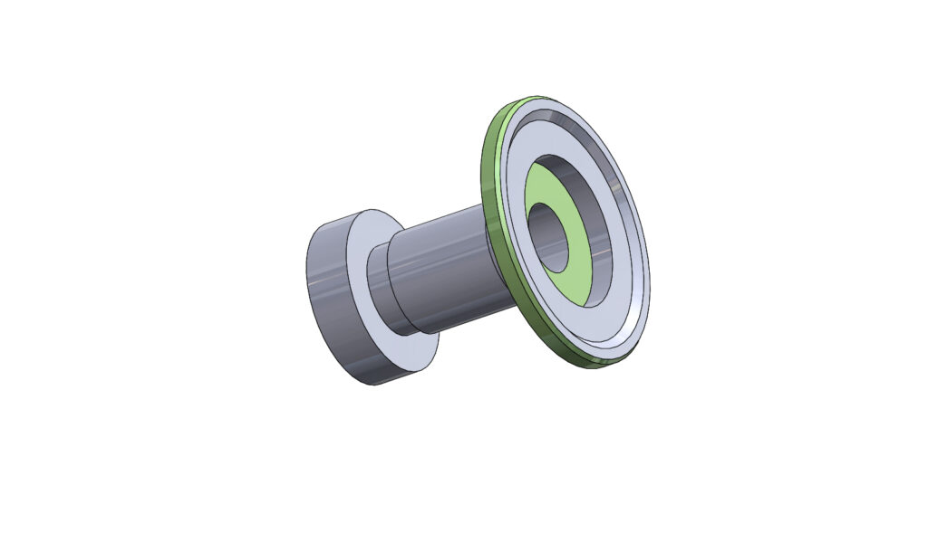

Competitor's product had issues with surface roughness worsening near the machining constant. SH7025 greatly suppressed the progression of damage to the cutting edge, maintaining good machining surface roughness, and achieving double the lifespan extension.
Industry | Miniature |
Component | Separated pipe |
Work material | S45C |
Machine(spindle type) | Swiss Lathe |
Tool family | Turning |
Tool category | External & Face turning |
Product name | SH7025 |
TSR No. | 5008T |
Tungaloy | Competitor | |
Holder | JSDJ2CR1212X11 | JSDJ2CR1212X11 |
Insert | DCGT11T302FN-JS | DCGT11T302FN-Medium chip breaker |
Edges par insert | 2 | 2 |
Grade | SH7025 | PVD |
Tool life (pcs/edge) | 400 | 200 |
Cutting speed V/c (m/min) | 150 | 150 |
Feed f (mm/rev) | 0.04 | 0.04 |
Depth of cut ap (mm) | 1 | 1 |
Coolant | Wet | Wet |
