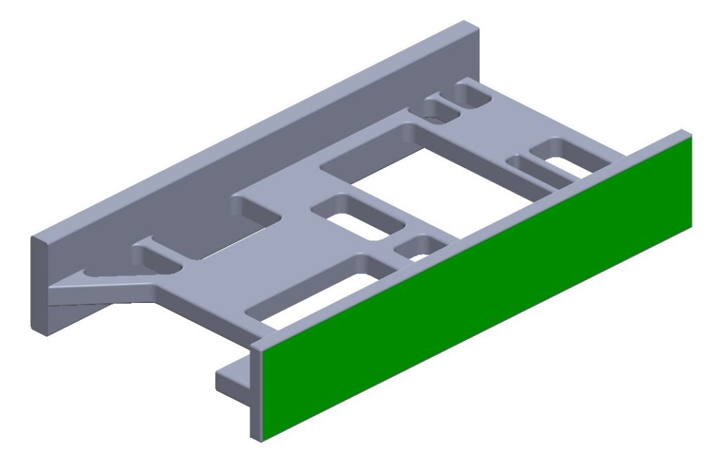

TungTri04 with its dense cutting edges prevented chipping by reducing load per cutting edge and its highly rigid body, offering stable machining at increased table feed. As the result, metal removal rate increased by 1.2 times and tool life by 5.0 times.
| Component | Casing |
| Work material | SCS13 |
| Machine(spindle type) | Vertical Machining Center Small(#30,HSK40) |
| Tool family | Milling |
| Product name | Tung-Tri |
| TSR No. | 1485M |
| Body | EPA04R025M25.0-05 | Indexable shoulder cutter |
| Effective number of teeth | 5 | 2 |
| Cutting diameter | 25 | 32 |
| Insert | TOMT040204PXER-MM | 2 cornered Positive inserts |
| Grade | AH3225 | PVD |
| Cutting speed V/c (m/min) | 150 | 150 |
| Feed per tooth f/z (mm/t) | 0.03 | 0.08 |
| Feed speed Vf (mm/min) | 286 | 239 |
| Depth of cut ap (mm) | 0.7 | 0.7 |
| Width of cut ae (mm) | 20 | 20 |
