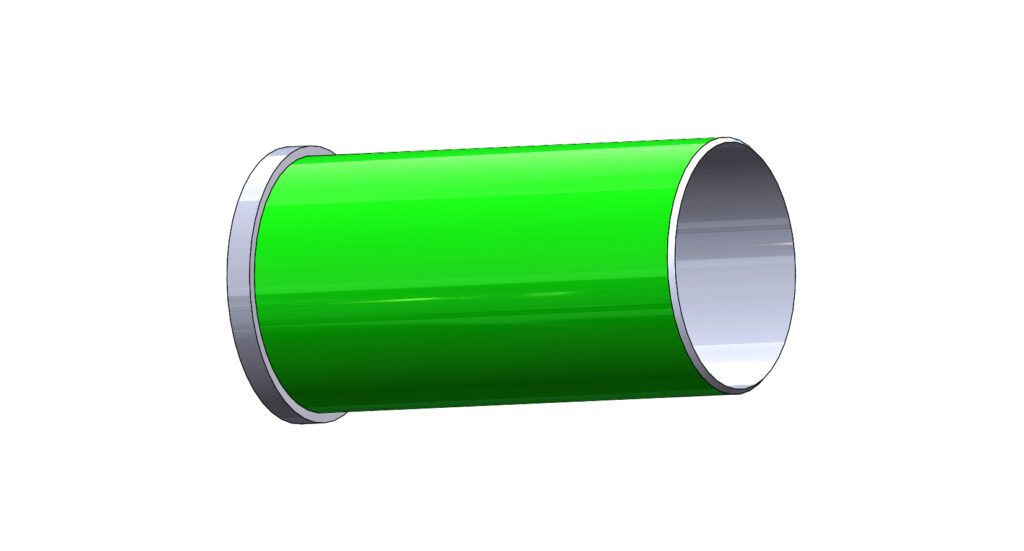

| Component | Cylinder Liner |
| Work material | FC200 |
| Product name | HC2 Ceramic Insert |
| TSR No. | 5282T |
| Insert | SNGN120408T01020 | |
| Grade | HC2 | Carbide |
| Tool life (pcs/edge) | 110 | 40 |
| Cutting speed V/c (m/min) | 600 | 400 |
| Feed f (mm/rev) | 0.5 | 0.5 |
| Depth of cut ap (mm) | 0.7 | 0.7 |
| Coolant | DRY | DRY |
