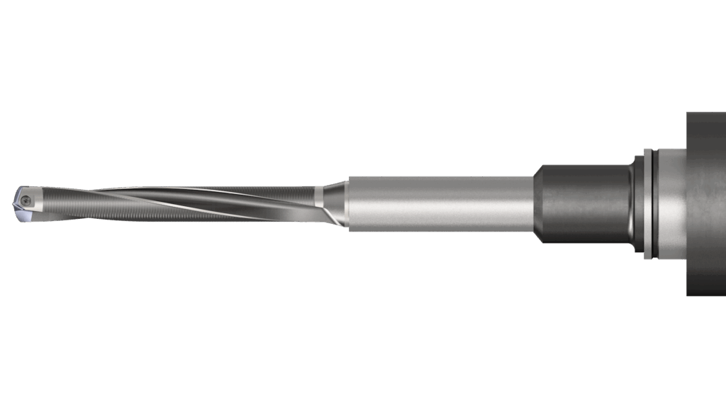

DrillForce-Meister achieved 1.9times higher productivity thanks to outstanding entry stability with SMC head and extremely rigid drill design.
There were various workpiece shapes and fixtures, but the ability to machine with a long overhang allowed us to unify the tooling.
| Industry | Heavy |
| Component | Housing |
| Work material | FCD600/GGG60 |
| Machine(spindle type) | Horizontal Machining Center Large(#50,HSK100) |
| Tool category | Drilling |
| TSR No. | 5275D |
| Body | TIS200F25-5+ long arbor | Head changeable drill |
| Head | SMC200 AH9130 | Head |
| Grade | AH9130 | PVD |
| Tool diameter DC (mm) | 20 | 20 |
| Hole depth H (mm) | 59.5 | 59.5 |
| Cutting speed V/c (m/min) | 60 | 40 |
| Feed f (mm/rev) | 0.25 | 0.2 |
| Feed speed Vf (mm/min) | 239 | 127 |
| Coolant | Internal Coolant | Internal Coolant |
