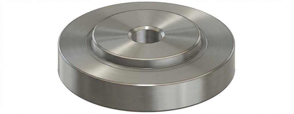

Vibration conditions: LFV (MODE 1): D0.5, Q0.5, f0.03
The current product reaches the end of its life due to poor dimensions and appearance after machining 700 pieces. TMV has stable dimensional accuracy and chip disposal, and can suppress burrs and chipping on the machined surface. As a result, it has achieved a lifespan 2.1 times longer.
| Industry | Miniature |
| Component | Bolt |
| Work material | SUS304 |
| Product name | Miniature - TMV Chipbreaker |
| TSR No. | 5113T |
| Holder | SDJCR | SDJCR Type |
| Insert | DCGT11T302MRTMV | |
| Grade | ST4 | Carbide Coated |
| Cutting speed V/c (m/min) | 51 | 51 |
| Feed f (mm/rev) | 0.03 | 0.03 |
| Depth of cut ap (mm) | 1.2 | 1.2 |
| Coolant | WET | WET |
