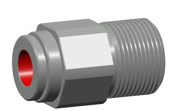

In drilling operations for INCONEL 718, replacing the conventional DMP118 head with the DMM118 head optimized for heat-resistant alloys improved tool life from 100 to 160 holes without changing cutting conditions, achieving a 60% increase in tool life. The total machined length increased from 1,000 mm to 1,600 mm while maintaining stable machining performance

TSR No. 5689H
Fitting
Body TID115F16-3 TID115F16-3
Head DMM118 AH9130 DMP118 AH9130
Grade AH9130 AH9130
Tool life (m/insert) 1.6 1
Number of workpieces (pcs/insert) 160 100
Tool diameter DC (mm) 11.8 11.8
Hole tolerance grade IT10 IT10
Hole depth H (mm) 10 10
Cutting speed V/c (m/min) 30 30
Feed f (mm/rev) 0.06 0.06
Feed speed Vf (mm/min) 809 809
Coolant Internal coolant Internal coolant
Tool life1.6 times
