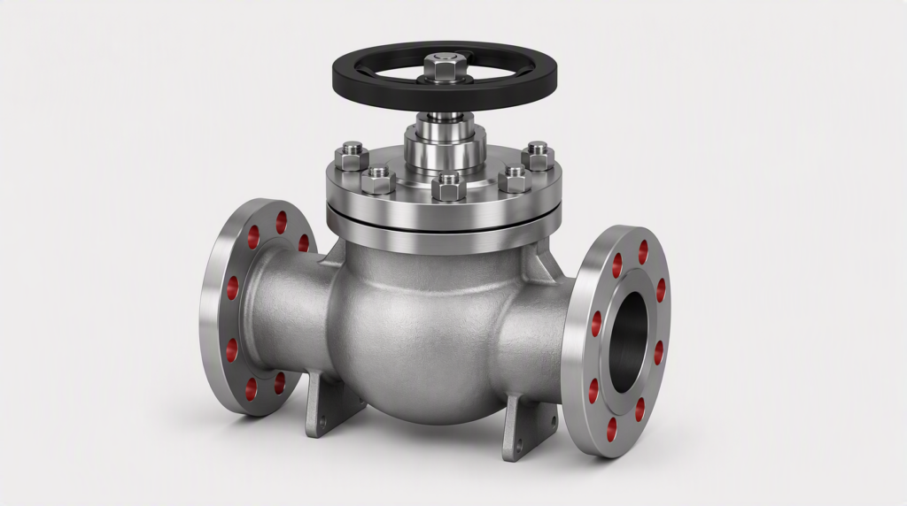

DrillForceMeister -Valve- AH9130
IMPROVE PRODUCTIVITY
DrillForceMeister provided 4.0 times longer tool life thanks to its highly wear resistant AH9130 grade and 1.3 times higher productivity rigid head clamping.
Compared to indexable insert drills, management has become easier because only the cutting head needs to be replaced.
| Industry | Oil & Gas |
| Component | Valve |
| Work material | SS400 low carbon steel |
| Machine(spindle type) | Vertical Machining Center Middle(#40,HSK63) |
| Tool category | Drilling |
| TSR No. | 5684D |
| Body | TIS270F32-3 | Indexable drill |
| Head | SMF270 AH9130 | Insert |
| Grade | PVD | PVD |
| Tool diameter DC (mm) | 27 | 27 |
| Cutting speed V/c (m/min) | 130 | 100 |
| Feed speed Vf (mm/min) | 153 | 118 |
| Coolant | Internal Coolant | Internal Coolant |
