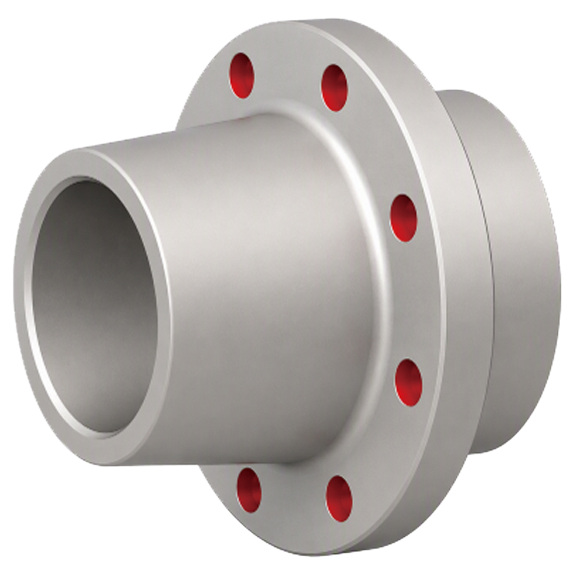

Tool life was extended by up to 1.4 times by applying the DMR head compared with a existed exchangeable-head drill.
| Component | Housing |
| Work material | FCD600 |
| Tool category | Drilling |
| TSR No. | 5657D |
| Body | TID140M10-3 | |
| Head | DMR141 | |
| Grade | AH9130 |
| Tool diameter DC (mm) | 14.1 | |
| Hole depth H (mm) | 25 | |
| Cutting speed V/c (m/min) | 80 | |
| Feed f (mm/rev) | 0.2 | |
| Feed speed Vf (mm/min) | 1,819 | |
| Coolant | Wet (Internal coolant) |
