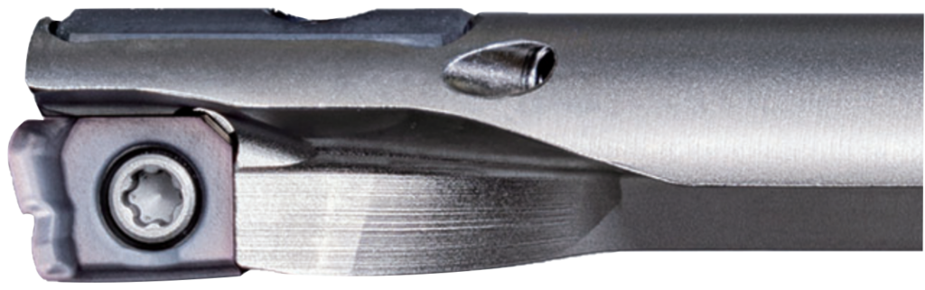

DeepTriDrill improved tool life - stable drilling
DeepTridrill demonstrated excellent performance in both machine load and surface roughness. Machining noise was also significantly reduced.
With a traditional brazed gundrill, once the tool is worn out, it must be completely removed from the machine. This is a complicated procedure that brings production to a halt.
In contrast, the indexable‑type gundrill allows spare parts to be replaced directly on the machine, resulting in extremely short machine downtime.
