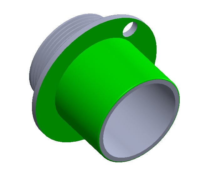

| Component | Shaft Parts |
| Work material | C30/S30CV |
| Product name | ISO-EcoTurn |
| TSR No. | 408T |
| Holder | AWLNR2525M0604-A | AWLNR2525M0604-A |
| Insert | WNMG060408E-TM | WNMG080408-Medium chip breaker |
| Grade | T9225 | CVD(P15) |
| Tool life (pcs/edge) | 280 | 200 |
| Cutting speed V/c (m/min) | 190 | 190 |
| Feed f (mm/rev) | 0.25 | 0.25 |
| Depth of cut ap (mm) | 2.5 | 2.5 |
