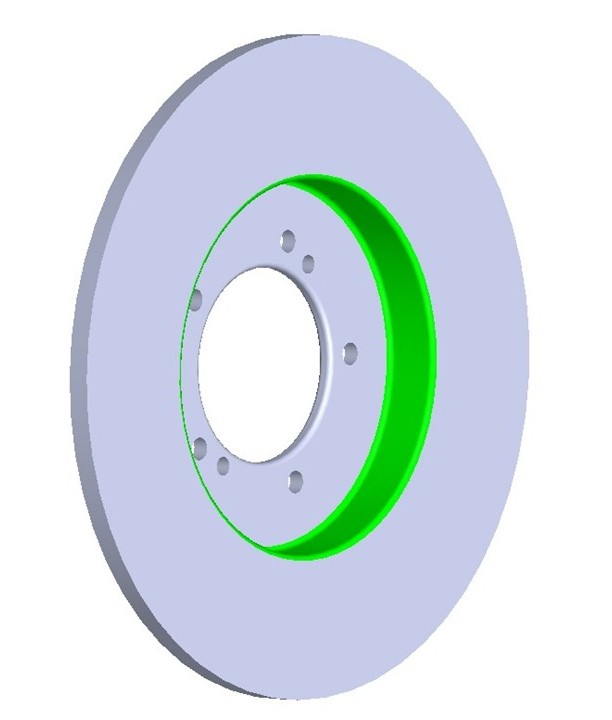

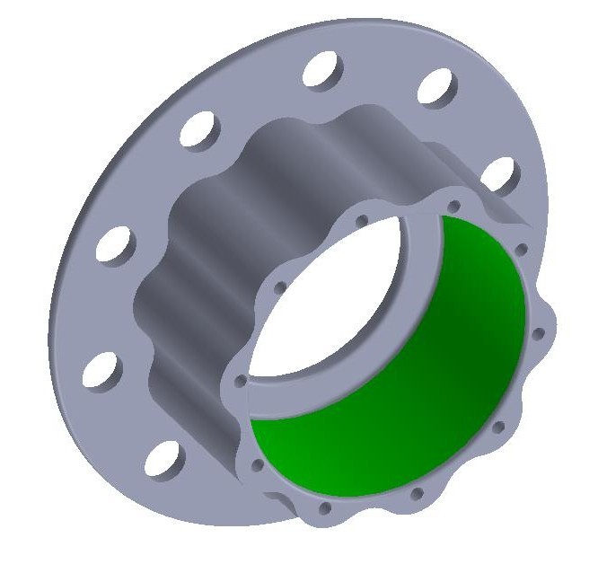

GT9530 – Pinion Gear Parts – GT9530
Stable tool life & Good wear resistance - GT9530 with “Premium Tec” allows excellent wear resistance by improving the adhesion resistance between the substrate and the coating and chipping resistance. Thus, GT9530 offers stable surface finish and longer tool life than competitors!
| Component | Pinion Gear Parts |
| Work material | Steel Plate Hot Commercial |
| Product name | GT9530 |
| TSR No. | 198T |
| Holder | ADJNR2525M15-A | ADJNR2525M15-A |
| Insert | DNMG150408-TSF | DNMG150408-Medium chip breaker |
| Grade | GT9530 | Cermet |
| Tool life (pcs/edge) | 600 | 400 |
| Cutting speed V/c (m/min) | 225 | 225 |
| Feed f (mm/rev) | 0.25 | 0.25 |
| Depth of cut ap (mm) | 0.3 | 0.3 |
