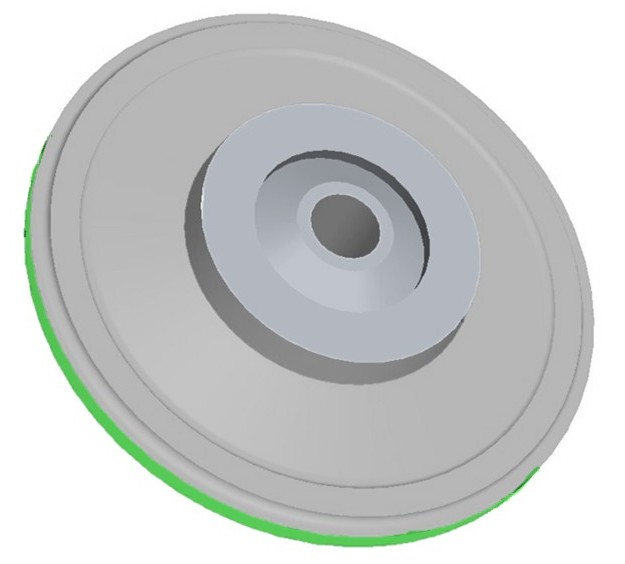

T6200 – Valve Parts – T6215
Stable machining
- T6215 with SM chipbreaker offers great wear resistance in external continuous machining.
- Because T6215 has extremely high wear and fracture resistance, it allows stable machining in the range from medium to high speed cutting.
| Component | Valve part |
| Work material | X5CrNiMo17-12-2 |
| Product name | T6200 |
| TSR No. | 194T |
| Holder | AWLNR2525M08-A | AWLNR2525M08-A |
| Insert | WNMG080408-SM | WNMG080408-Medium chip breaker |
| Tool life (pcs/edge) | 35 | 25 |
| Cutting speed V/c (m/min) | 160 | 160 |
| Feed f (mm/rev) | 0.3 | 0.3 |
| Depth of cut ap (mm) | 2 | 2 |
