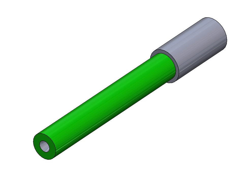

T6200 – Flange Parts – T6215
Excellent chipping & wear resistance
- T6215 with SM chipbreaker offers high wear resistance and excellent chip control in continuous cutting of flange parts.
- T6215 drastically reduces chipping due to its coating with outstanding chipping resistance, so that it allows longer tool life than competitors in continuous stainless steel machining.
| Industry | Oil & Gas |
| Component | Flange Parts |
| Work material | X5CrNi18-9 |
| Product name | T6200 |
| TSR No. | 166T |
| Holder | AWLNL2525M08-A | AWLNL2525M08-A |
| Insert | WNMG080412-SM | WNMG0804012-Medium chip breaker |
| Grade | T6215 | CVD |
| Tool life (pcs/edge) | 350 | 300 |
| Cutting speed V/c (m/min) | 160 | 160 |
| Feed f (mm/rev) | 0.27 | 0.27 |
| Depth of cut ap (mm) | 1.2 | 1.2 |
