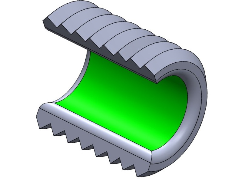

T9200 – Final Gear – T9215
- T9215 provides a good balance of wear and fracture resistance.
- T9215 offers stable and long tool life in continuous cutting of ductile cast iron due to the reduction in chippings on the cutting edge.
| Component | Final Gear |
| Work material | 600-3 |
| Product name | T9200 |
| TSR No. | 113T |
| Holder | Special tool holder | Special tool holder |
| Insert | DCMT11T308-PS | DCMT11T308-Semifinish chip breaker |
| Grade | T9215 | CVD(P25) |
| Tool life (pcs/edge) | 300 | 200 |
| Cutting speed V/c (m/min) | 180 | 180 |
| Feed f (mm/rev) | 0.3 | 0.3 |
| Depth of cut ap (mm) | 1.5 | 1.5 |
| Coolant | Oil (External) | Oil (External) |
