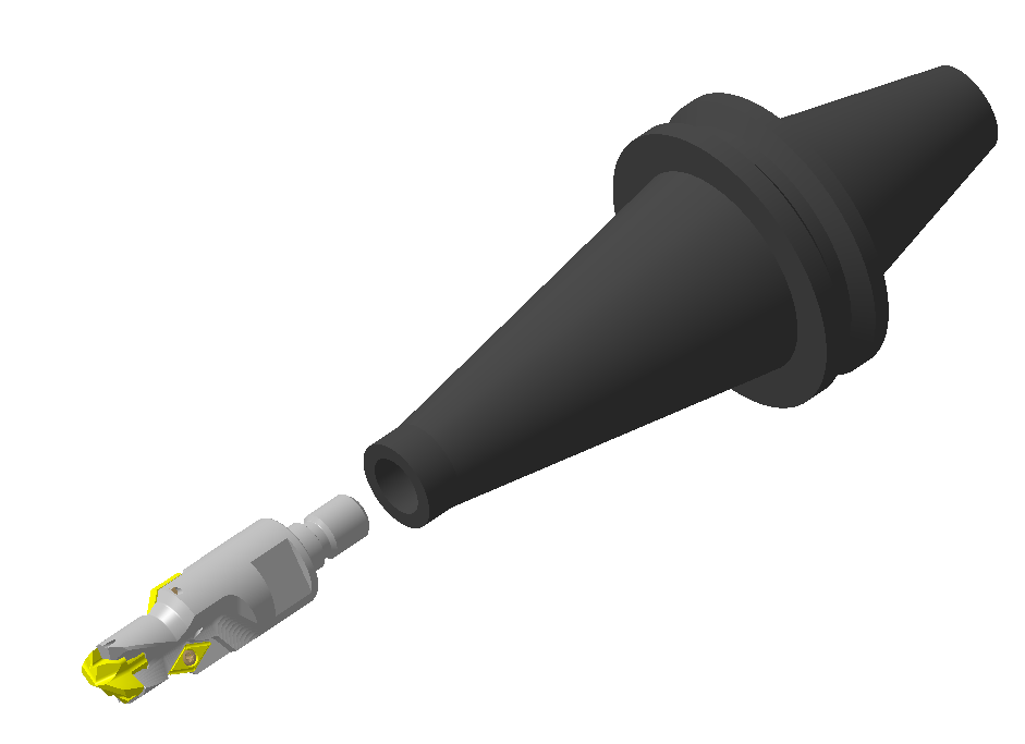

This case involves machining an automotive hub bearing component.
Compared with the existing solid-tool solution, the new setup achieved three times the tool life while also integrating the chamfering process.
With the previous tool, the cutting edge reached the end of its life after machining around 800 parts, and the long tool overhang caused instability during machining.
To address this, we proposed the use of DrillMeister with a TUNGFLEX connection. This tool is equipped with a chamfering edge, enabling both drilling and chamfering in a single operation.
By improving tool rigidity, DrillMeister has achieved a significant increase in tool life.
