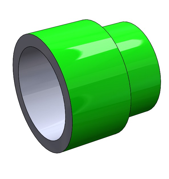

By using NTK’s TMV-650, cutting speed was slightly lower than the competitor’s, but it achieved excellent chip control and 1.7 times longer tool life.
The TMV geometry ensured stable cutting, reduced vibration, and improved surface finish.
Additionally, the number of corners increased from 4 to 6, which also contributed to cost reduction.
| Industry | Miniature |
| Component | Pressure Control Device Components |
| Work material | AISI/SAE 431 |
| Product name | Miniature - TMV Chipbreaker |
| TSR No. | 5432T |
| Insert | TNGG160404MRTMV | CNMG120404 |
| Edges par insert | 6 | 4 |
| Grade | 650 | CVD Coated Carbide |
| Tool life (pcs/edge) | 85 | 50 |
| Cutting speed V/c (m/min) | 144 | 161 |
| Feed f (mm/rev) | 0.14 | 0.18 |
| Depth of cut ap (mm) | 1.52 | 1.52 |
| Number of pass | 2 | 2 |
| Coolant | WET | WET |
