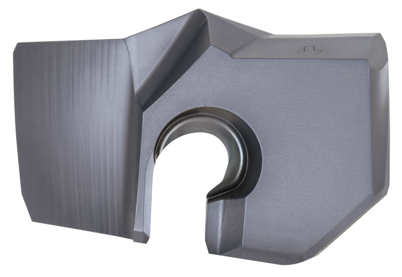

DrillForceMeister SMF head achieved 2.9 times better productivity and become stable machining thanks to self- centering cutting edge and high regidity head clamping system.
| Industry | Oil & Gas |
| Component | Valve |
| Work material | S25C / C25 |
| Machine(spindle type) | Horizontal Machining Center Large(#50,HSK100) |
| Tool category | Drilling |
| TSR No. | 5414D |
| Body | TIS390F40-3 | Indexable drill |
| Head | SMF390 | Insert |
| Grade | AH9130 | PVD |
| Tool diameter DC (mm) | 39 | 39 |
| Hole depth H (mm) | 105 | 105 |
| Cutting speed V/c (m/min) | 100 | 150 |
| Feed f (mm/rev) | 0.35 | 0.08 |
| Feed speed Vf (mm/min) | 286 | 98 |
| Coolant | Internal Coolant | Internal Coolant |
