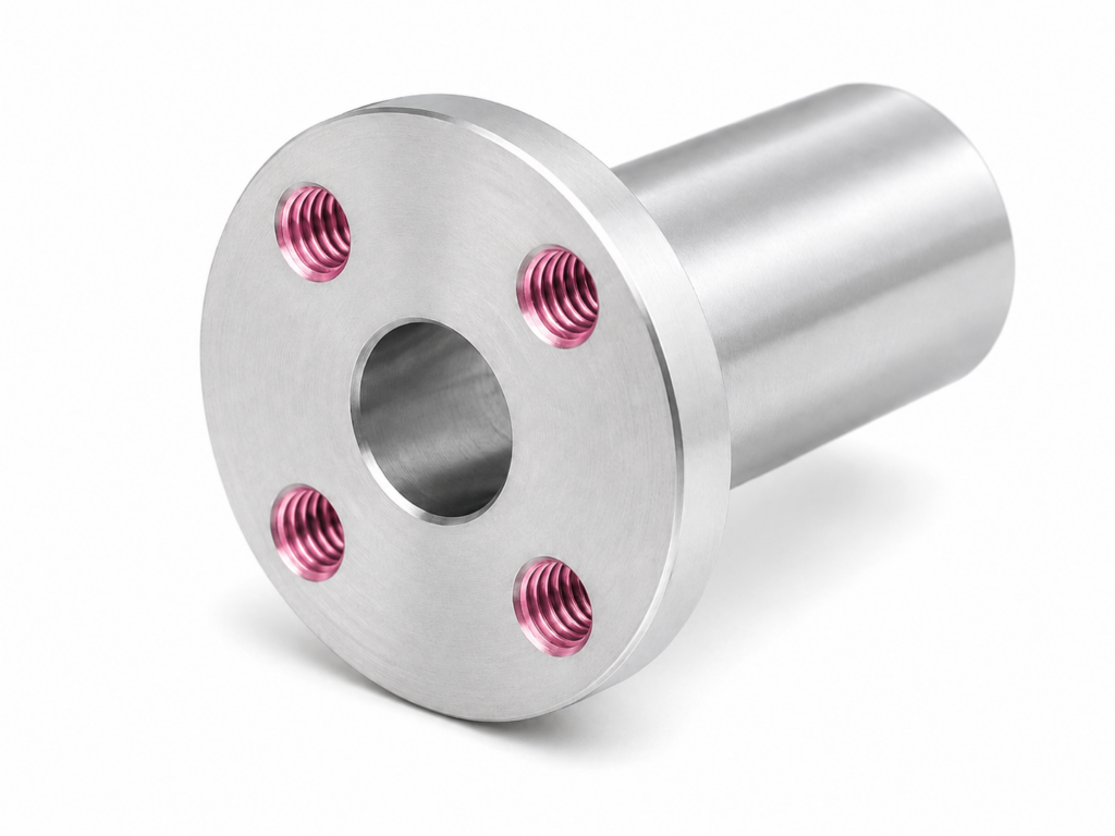

TungTap ‐ Pump element – PB060
The heat-resistant grade PB060 prevented both wear and breakage, resulting in a threefold improvement in tool life.
| Industry | Oil & Gas |
| Component | Pump element |
| Work material | Inconel |
| Tool category | Tapping |
| Product name | TungTap |
| TSR No. | 5401D |
| Body | TS-M6X1-DNCY PB060 | M6x1 tap |
| Grade | PB060 | TiN + Powdered HSS |
| Tool diameter DC (mm) | M6x1 | M6x1 |
| Pilot hole diameter (mm) | 5 | 5 |
| Hole depth H (mm) | 8 | 8 |
| Cutting speed V/c (m/min) | 3 | 3 |
| Feed f (mm/rev) | 1 | 1 |
| Feed speed Vf (mm/min) | 160 | 160 |
| Coolant | Oil, external | Oil, external |
