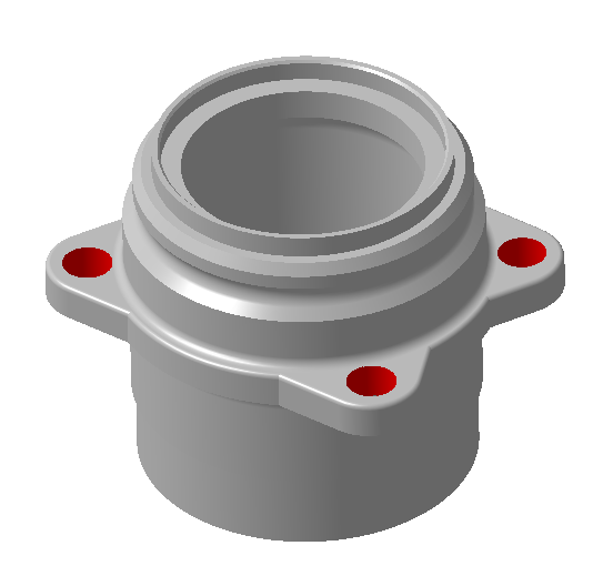

DrillForceMeister – Seal pin – AH725
DrillForce-Meister provided 1.25 times increased tool life thanks to highly wear resistance AH9130 grade.
| Industry | Power Generation |
| Component | Seal pin |
| Work material | SCM440 |
| Machine(spindle type) | Horizontal Machining Center Middle(#40,HSK63) |
| Tool category | Drilling |
| TSR No. | 1621D |
| Body | TIS320F40-3 | Head changeabledrill |
| Head | SMP320 | Drill head ø32 |
| Grade | AH9130 | PVD |
| Machining length (m) | 45 | 36 |
| Tool diameter DC (mm) | 32 | 32 |
| Hole depth H (mm) | 90 | 90 |
| Cutting speed V/c (m/min) | 120 | 110 |
| Feed f (mm/rev) | 0.23 | 0.22 |
| Feed speed Vf (mm/min) | 275 | 241 |
| Coolant | Internal supply | Internal supply |
